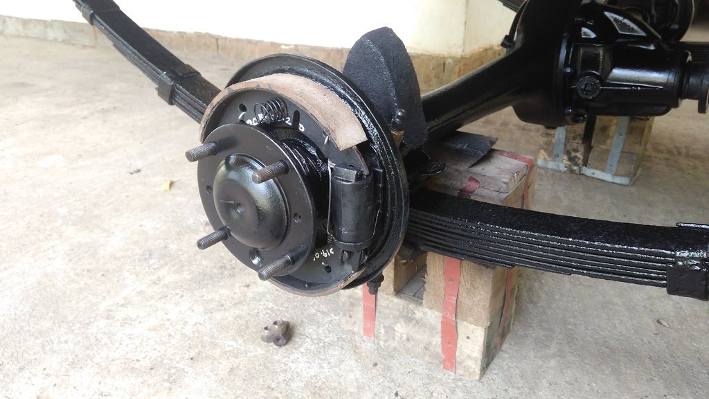

All mechanical work on the project Moggie will discuss here. This was the differential original status.
Cleaned & painted differential
Back brake liners were wet with leaked differential oil because of weak oil seals. Found matching oil seal from local market and hope it will fix the leaking.
Cleaned & painted brake shoes with newly applied liners.
Cleaned and painted leaf springs
Present status

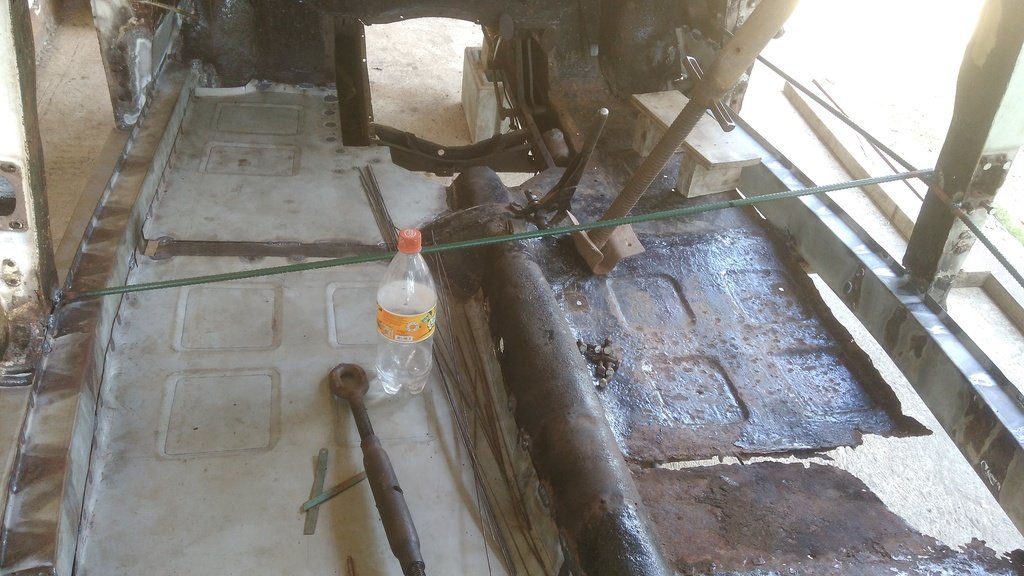

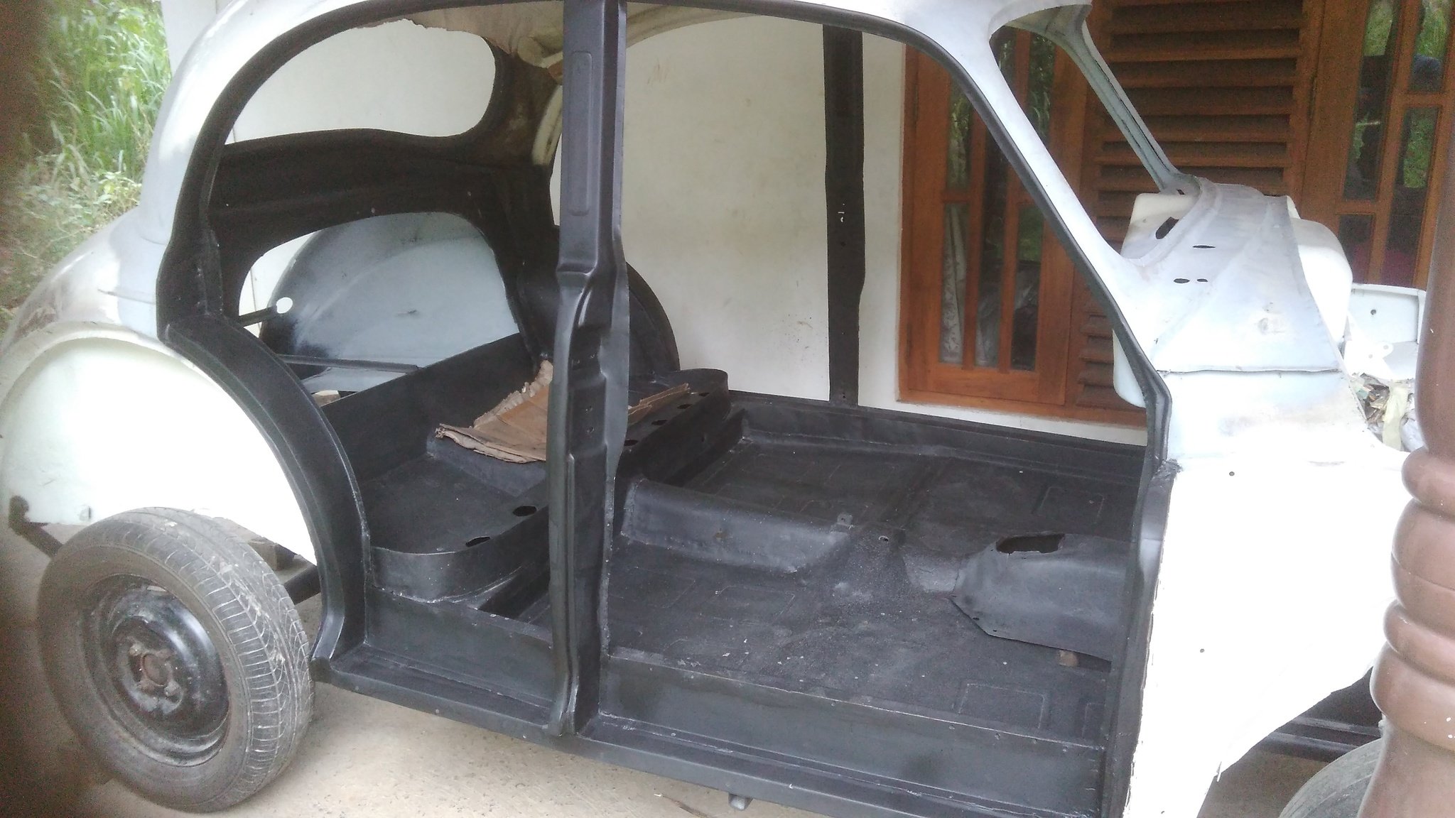

Bodywork started after disassembling almost all parts. Remain only the outer shell of the car with wiring harness which can not pullout easily. Gauge 14 & 18 zinc coated metal sheets used for most places.
Firstly cut the right side of the chassis and welded new bar.
Then the left side and floor board plates one by one. All door bottoms, front and back wings repaired. Mean time door hinge pins refilled at a lathe workshop. Finally attached all doors and wings again to check the aligning.
Carbide 9kg and a oxygen cylinder consumed for this works.

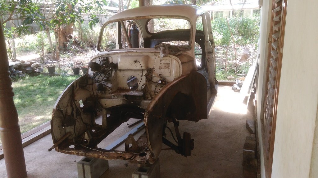

Restoration work began. The idea is to work at home. Found a person to do the tinker work. I do the mechanical work and hoping to do the paint job as well in the future. Firstly removed the interior parts such as car seats. After that, the four doors were removed. Then front and back wings, bonnet & boot. Finally the differential and the engine were removed.

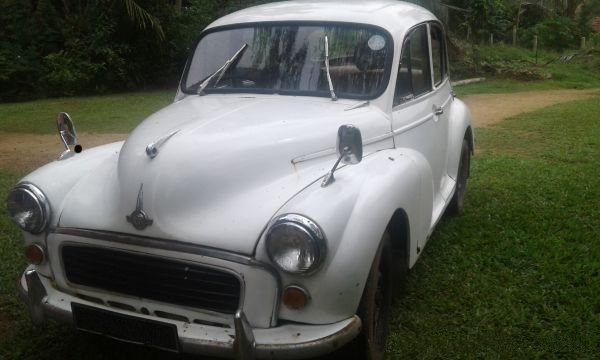

The car was exposed to the sunlight & rain for a long time. So there was corrosion on almost all body panels and floorboard too. Cleaned the plug wires, filled the tank, connected a charged battery and attempt to start it. After several attempt it started. The destination (my home) was 120 km and we started the journey around 11.00 am. As I was aware cars condition, selected rural roads. Brakes were very weak. So could not exceed 30kmh. During the trip had to replace a tire and the fan belt. Finally reached to the destination around 9.00 pm. Here are some initial condition pictures.
